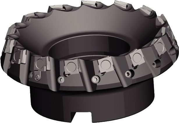

Fix-Perfect™ 20° Cast Iron Series • Shell Mill • Fixed Pockets • Inch
Tangential face milling cutter for cast iron machining.
Material Number1724378
ISO Catalog ID50A05RP70SP12CUFPANSI Catalog ID50A05RP70SP12CUFP

  • Face MillingFace Milling
Drawings for 1724378
[D1] Effective Cutting Diameter50.8 mm
[D1] Effective Cutting Diameter2 in
[D] Adapter / Shank / Bore Diameter19.05 mm
[D] Adapter / Shank / Bore Diameter0.75 in
[D2] Maximum Body Diameter63.6 mm
[D2] Maximum Body Diameter2.5039 in
[D6] Hub Diameter 44.45 mm
[D6] Hub Diameter 1.75 in
[L] Overall Length 44.45 mm
[L] Overall Length 1.75 in
[AP1MAX] 1st Maximum Cutting Depth5.89 mm
[AP1MAX] 1st Maximum Cutting Depth0.232 in
Number of Inserts5
Number of Adjustable Inserts0
Weight Pounds1.19
Max RPM8595
  • Milling cutter for roughing of cast iron and compacted graphite iron (CGI).
  • High feed rates through tangentially mounted inserts.
  • Pocket design protects non-engaged cutting edges.
  • Insert stud clamping mechanism safely manages high RPM's.
