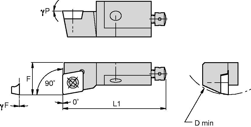

Drawings for 1098551
Material Number1098551
ISO Catalog IDSCFPR06CA05
ANSI Catalog IDSCFPR06CA05
[DM] Minimum Bore Diameter 20 mm
[DM] Minimum Bore Diameter 0.7874 in
[F] F Dimension 8 mm
[F] F Dimension 0.315 in
[L1] Tool Length 25 mm
[L1] Tool Length 0.9843 in
[GAAP] Axial Rake Angle0
Gage InsertCP..050204/CP..18151
