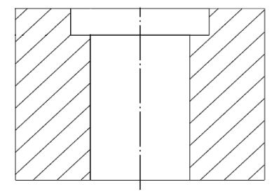

Perhaps the most common example of a flat bottom hole is one that's counterbored, which allows a socket head cap screw to sit flush with the upper surface of whatever component it's bolted to. Creating this shape requires a cutting tool with a 180-degree point. It could be a specialty tool with an obvious name—a counterbore—but in many shops, the most expedient solution is to modify an appropriately-sized drill bit and use it to cut the feature (more on this shortly). That, or interpolate the counterbore with an end mill, assuming a CNC machining center is available.

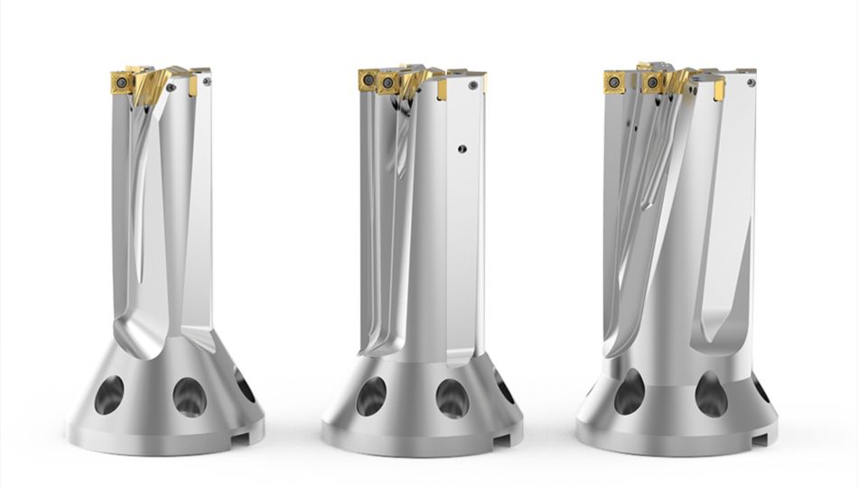

The flat bottom drill point design of the FBX Drill eliminates radial forces, making it ideal for applications on machines with lower horsepower and pre-machining high-temperature alloy airframe structural parts.

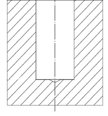

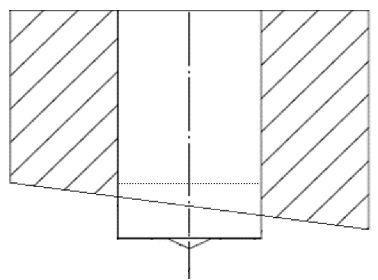

So what are those other applications? Counterboring is one, but so is the drilling of blind, flat-bottom holes. These are often used to house electronic components such as sensors, or to position a pin or shaft in an assembly. Using a flat bottom drill to punch holes in thin workpieces or stacks of thin plates (a common practice in the heat exchanger industry) tends to reduce the inevitable burr on the part's exit side. A similar argument can be made for holemaking in tubes and pipes as well as drilling into angled surfaces, or breaking through into intersecting holes during hydraulic manifold production.

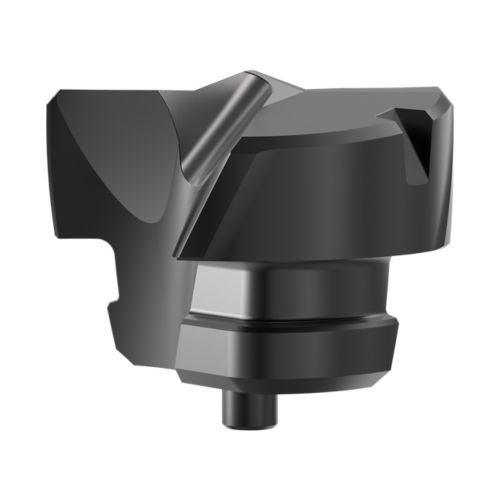

Check out KenTIP™ FS in action. The FEG insert, In conjunction with the other KenTIP FS inserts (HPG, HPC, HPL geometries), can be utilized as a pilot drill point for deep-hole applications.

Kennametal’s KenTIP FS FEG modular flat bottom drill boasts four margin lands for enhanced stability, a conical center point for improved centering, and corner chamfer to reduce burrs on break out and to improve tool life.

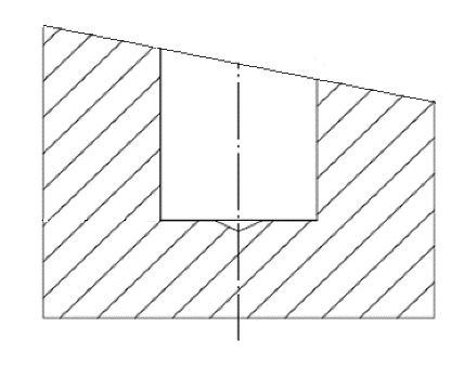

Flat bottom drill in hand, here are some guidelines to achieving the best hole quality possible. Using the HSS steel drill just described, most of the metal removal will be done with one of the 118-degree or 130-degree tools mentioned at the outset—just drill to the desired depth, then follow up with the flat bottom tool to clean out the point. For holes much deeper than 5x the diameter, start with a spot drill or create a pilot hole roughly one diameter deep, as this will keep the drill from wandering. For angled surfaces, it’s a good idea to first mill a flat with an end mill, then spot drill and drill as normal. Also, reduce feedrates slightly when exiting an angled hole or when drilling into intersecting holes. As with any HSS or cobalt drill, pecking will be necessary to clear the chip and introduce cutting fluid into the hole. As always, a high-quality collet chuck, hydraulic, or mechanical toolholder will provide the best results.
Learn more about the FBX Drill's advanced drill body design for flat bottom drilling, maximum metal removal rates, and decreased cycle times when machining aerospace structural components.

The best solution of all is a modular flat bottom drill, something that wasn't around when machinists began grinding their own tools. They are now, however, and one of the best examples of this is Kennametal’s KTFS-series drill with FEG geometry. In holes up to 12xD, there's no need for a pilot hole, nor is one needed on angled surfaces up to 5xD. Countersinks, intersecting holes, angled breakouts, stacked plates—all are easily produced with an FEG-style modular flat bottom drill, and all will benefit from superior hole straightness, improved tool life, and greater productivity.

Blind Hole Line Drawing
A Blind Hole
Counterbore Line Drawing
A Counterbore
Angled Exit Line Drawing
An Angled Exit
Inclined Entry Line Drawing
An Inclined Entry
