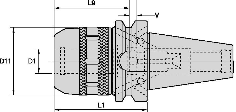

[D1] Adapter / Shank / Bore Diameter19.05 mm
[D1] Adapter / Shank / Bore Diameter0.75 in
[D11] Lock Nut Diameter53 mm
[D11] Lock Nut Diameter2.0866 in
[L1] Gage Length105 mm
[L1] Gage Length4.1339 in
[L9] Clamping Length 49 mm
[L9] Clamping Hole Length 1.929 in
[V] Adjustment Range 20 mm
[V] Adjustment Range 0.7874 in
Stop Screw ID Drive Size2.5 mm & 5 mm
Weight Kilograms4.4
