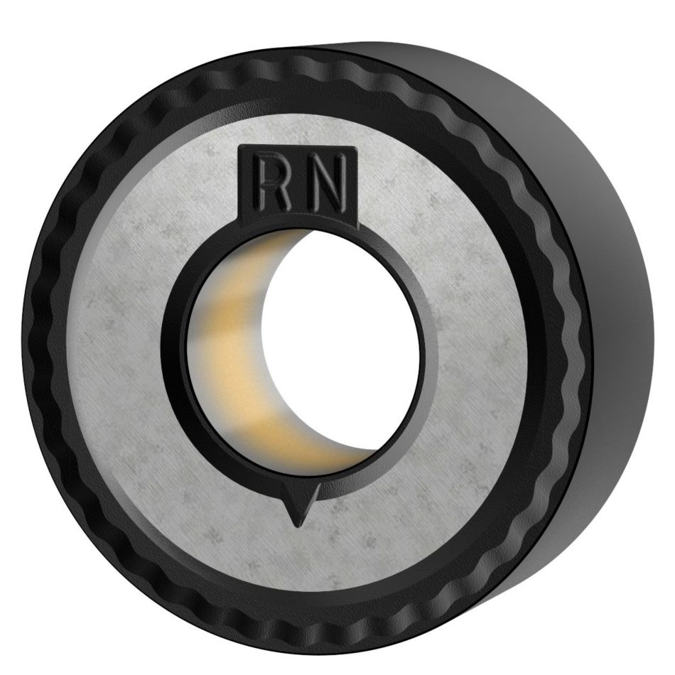

製品番号5425596
ISO カタログ IDRNMG090300RN
ASIカタログIDRNMG32RN
GradeKCP25B
Beyondドライブの材種Beyond™ Drive™
[D] Insert IC Size9.525 mm
[D] Insert IC Size0.375 in
[S] Insert Thickness3.18 mm
[S] Insert Thickness0.125 in
[D1] Insert Hole Size 3.81 mm
[D1] Insert Hole Size 0.15 in
ワーク材料
等級
KCP25B
KCP25B
Composition: A tough cobalt-enriched carbide grade with a newly designed multilayer MTCVD-TiCN-Al2O3-TiOCN coating with superior interlayer adhesion.
Application: Best general-purpose turning grade for most steels and ferritic and martensitic stainless steels. The substrate design ensures adequate deformation resistance with excellent insert edge strength. Coating layers offer good wear resistance over a wide range of machining conditions and the post-coat treatment minimises microchipping and improves coating adhesion to substrate leading to long tool life and improved workpiece finishes.
特徴と利点
  • 要件の厳しいアプリケーションに適した強力な切れ刃線での粗加工用ブレーカー形状
  • Beyond™ Drive™材種を含む
