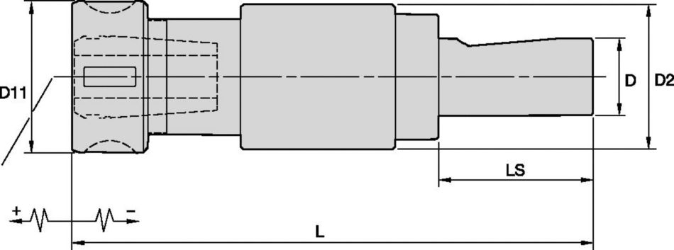

Drawings for 1017625
メートル
インチ
製品番号1017625
ISO カタログ IDSS150TCTG100756
ASIカタログIDSS150TCTG100756
[CST] Catalog Collet SeriesTG100
[D11] Lock Nut Diameter59.995 mm
[D11] Lock Nut Diameter2.362 in
[D2] Body Diameter 1 Workpiece Side 63.5 mm
[D2] Body Diameter 1 Workpiece Side 2.5 in
[L] Overall Length 192.075 mm
[L] Overall Length 7.562 in
[LS] Shank Length 68.072 mm
[LS] Shank Length 2.68 in
[LTN] Slide Tension 12.7 mm
[LTN] Slide Tension 0.5 in
[LCM] Slide Compression 3.175 mm
[LCM] Slide Compression 0.125 in
Torque Catalog Foot Pounds150
Weight Pounds2.12
[D] Adapter / Shank / Bore Diameter38.1 mm
[D] Adapter / Shank / Bore Diameter1.5 in
