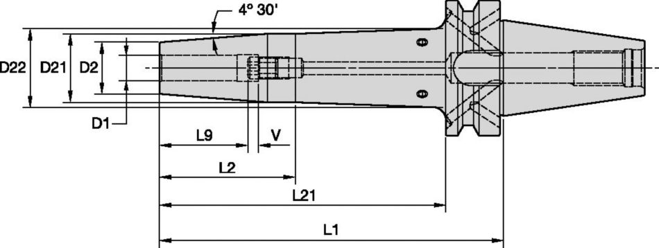

製品番号3615357
ISO カタログ IDBT40BHPVTT075354
ANSIカタログIDBT40BHPVTT075354
[D1] Adapter / Shank / Bore Diameter19.05 mm
[D1] Adapter / Shank / Bore Diameter0.75 in
[D2] Body Diameter 1 Workpiece Side 33 mm
[D2] Body Diameter 1 Workpiece Side 1.299 in
[D21] Body Diameter 2 Workpiece Side41 mm
[D21] Body Diameter 2 Workpiece Side1.614 in
[L1] Gage Length90 mm
[L1] Gage Length3.543 in
[L2] Usable Length 63 mm
[L2] Usable Length 2.48 in
[L9] Clamping Length 41 mm
[L9] Clamping Hole Length 1.614 in
[V] Adjustment Range 10 mm
[V] Adjustment Range 0.3937 in
Stop Screw ID Drive Size8 mm
Weight Kilograms1.35
