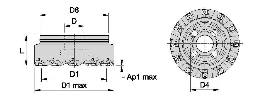

Fix-Perfect™ Cast Iron Finisher • Shell Mill • Metric
Tangential face milling cutter for fine-finishing of cast iron.
Material Number102223490
- Milling cutter for fine-finishing of cast iron and compacted graphite iron (CGI).
- Perfect axial runout without insert adjustment.
- High-precision pocket seats for excellent surface finish and flatness.
- Easy handling and cutter set up.
Face Milling
Milling - Through Coolant
Milling - Side and Face
Insert Selection Guide
