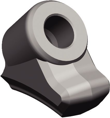

38mm Series Step • Heavy
38/30mm Step Shank Block Systems
Material Number1547387
ISO Catalog IDU43XHD BLOCKANSI Catalog IDU43XHD BLOCK
38/30mm Step Shank Block Systems - 1547387 - Kennametal.com
$102.29/each
    Drawings for 1547387
    [B2] Overall Width 78.684 mm
    [B2] Overall Width 3.0978 in
    [D1] Adapter / Shank / Bore Diameter38.24 mm
    [D1] Adapter / Shank / Bore Diameter1.5055 in
    [D1S] Second Adapter / Shank / Bore Diameter30.213 mm
    [D1S] Second Adapter / Shank / Bore Diameter1.1895 in
    [DSS] Diameter Seating Surface 69.85 mm
    [DSS] Diameter Seating Surface 2.75 in
    [WW] Weld Width 69.85 mm
    [WW] Weld Width 2.75 in
    [H1] Centerline Height 83.058 mm
    [H1] Centerline Height 3.27 in
    [H2] Overall Height 107.754 mm
    [H2] Overall Height 4.2423 in
    [LW] Weld Length 115.207 mm
    [LW] Weld Length 4.5357 in
    Block Angle [BA]45
    Rotating tungsten carbide pick • 38mm (1.50") Step-Shank-External Snap Ring • Plug Tip for hard cutting
