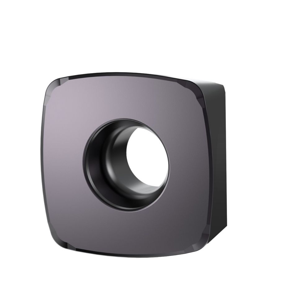

7792VXD12 Series • Carbide Insert • XDLW-D • Heavy Machining
7792VXD12 Series • Carbide Insert • XDLT-D411 • Light Machining
7792VXD12 Series • Carbide Insert • XDLT-D41 • Medium Machining
7792VXD12 Series • Carbide Insert • XDLT-D721 • Medium Machining
7792VXD12 Series • Carbide Insert • XDPT-D41 • Medium Machining
7792VXD12 Series • Carbide Insert • XDPW-D • Heavy Machining
