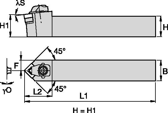

Drawings for 1540492
Material Number1540492
ISO Catalog IDCSDNN164DMX5
ANSI Catalog IDCSDNN164DMX5
[H] Shank Height 25.4 mm
[H] Shank Height 1 in
[B] Shank Width 25.4 mm
[B] Shank Width 1 in
[F] F Dimension 12.7 mm
[F] F Dimension 0.5 in
[L1] Tool Length 152.4 mm
[L1] Tool Length 6 in
[LH] Head Length 35.052 mm
[LH] Head Length 1.38 in
Gage InsertSN.X452
Shim Screw ID Drive SizeT20
Clamp Screw ID Drive SizeT25
