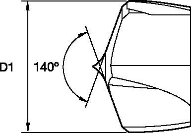

Material Number5515222
ISO Catalog IDKSEMP3700HPGM
ANSI Catalog IDKSEMP3700HPGM
GradeKC7315
[D1] Drill Diameter 37 mm
[D1] Drill Diameter 1.4567 in
[L5] Drill Point Length6.51 mm
[L5] Drill Point Length0.2563 in
[SSC] Insert Seat Size10

  • HPG geometry for modular drilling in steels, stainless steel, cast iron and high temperature alloys
  • With straight cutting edge for maximum stability in short chipping steels and interrupted cuts
