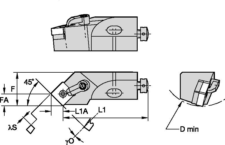

Drawings for 3330281
Material Number3330281
ISO Catalog IDMSSNR16CA12
ANSI Catalog IDMSSNR16CA4
[DM] Minimum Bore Diameter 60 mm
[DM] Minimum Bore Diameter 2.3622 in
[F] F Dimension 25 mm
[F] F Dimension 0.9843 in
[FA] F A Dimension 8.7 mm
[FA] F A Dimension 0.3425 in
[L1] Tool Length 53 mm
[L1] Tool Length 2.0866 in
[L1A] L1 A Dimension 8.33 mm
[L1A] L1 A Dimension 0.328 in
Inclination Angle13
[GAAO] Orthogonal Rake Angle0
Gage InsertSN..120408/SN..432
