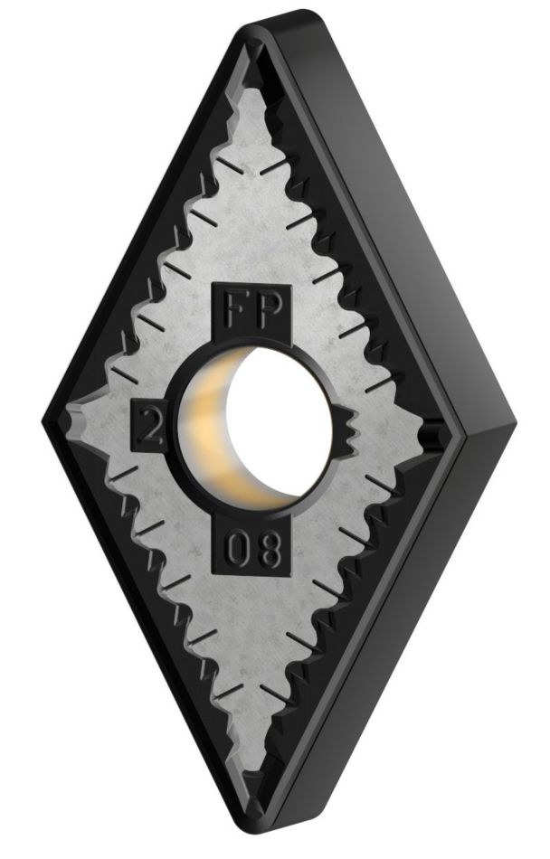

Material Number3758791
ISO Catalog IDDNMG150604FPANSI Catalog IDDNMG441FP
Kenloc™ DNMG ISO/ANSI Turning Insert 3758791 - Kennametal
$57.29/each
Drawings for 3758791
GradeKCM15
[D] Insert IC Size12.7 mm
[D] Insert IC Size0.5 in
[D1] Insert Hole Size 5.16 mm
[S] Insert Thickness6.35 mm
[S] Insert Thickness0.25 in
[Rε] Corner Radius 0.4 mm
[Rε] Corner Radius 0.016 in
KCM15
KCM15
Composition: Nanostructured PVD TiAlN coated fine-grain carbide with a golden TiN top layer for better wear identification and superior surface finish.
Application: A state-of-the-art surface condition enhances low adhesion potential to stainless steel materials and offers superior chip evacuation even in low-pressure coolant applications. Applicable for stainless steel and high-temperature resistant materials.
  • Finishing geometry with positive rake face for chip control in difficult materials
