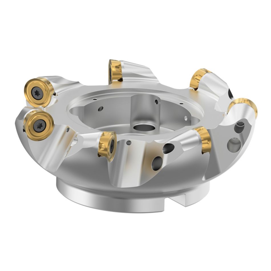

KSRM™ 20 • Carbide Insert • RCGT-GF • Medium Machining
Copy milling insert with six cutting edges, precision ground.
Material Number5517575
ISO Catalog IDRCGT2006M0SGFJANSI Catalog IDRCGT2006M0SGFJ
- P Steel
- M Stainless Steel
- S High-Temp Alloys
- H Hardened Materials
| Material Number | 5517575 |
| ISO Catalog ID | RCGT2006M0SGFJ |
| ANSI Catalog ID | RCGT2006M0SGFJ |
| Grade | KCSM30 |
| [D] Insert IC Size | 20 mm |
| [D] Insert IC Size | 0.787 in |
| [S] Insert Thickness | 6.35 mm |
| [S] Insert Thickness | 0.25 in |
| Average Chip Thickness [HM] | 0.102 mm |
| Average Chip Thickness [HM] | 0.004 in |
| Insert Number of Indexes | 6 |
- Steel
- Stainless Steel
- High-Temp Alloys
- Hardened Materials
KCSM30
Submicron substrate coated with high-performance TiAlN-PVD coating is an excellent choice for titanium, but also high-temperature alloys and stainless with higher speeds for light to medium cuts. First choice for application with thin to medium chip thickness, dry and wet.
- Precision ground insert for best surface finish.
- Single-sided copy milling insert with up to six indexes
At 10,00 Axial Depth of Cut (ap)
