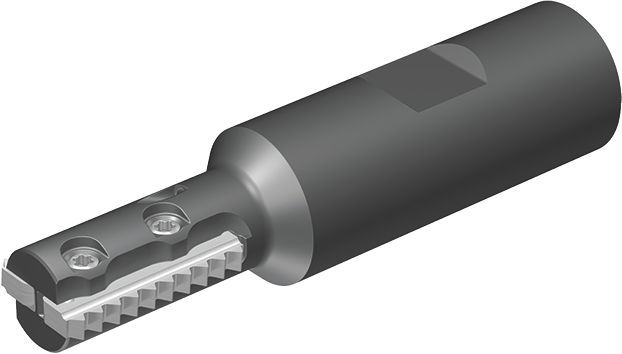

TM24 Parallel Cutter Metric
TM24 • Weldon® Shank
Material Number5593149
ISO Catalog IDTM24D14L26Z1ANSI Catalog IDTM24D14L26Z1

[D1] Effective Cutting Diameter13.6 mm
[D1] Effective Cutting Diameter0.535 in
[D] Adapter / Shank / Bore Diameter20 mm
[D] Adapter / Shank / Bore Diameter0.787 in
[D2] Maximum Body Diameter10.7 mm
[D2] Maximum Body Diameter0.421 in
[L] Overall Length 82 mm
[L] Overall Length 3.228 in
[L3] Usable Length26 mm
[L3] Usable Length1.024 in
Number of Inserts1
  • 14–16mm cutting diameter range.
  • For internal and external threading on most types of workpiece materials.
  • One tool is used for both right- and left-hand threads.
  • All cutters have through-coolant capability.
  • Utilizes inserts with various profiles and pitches.
