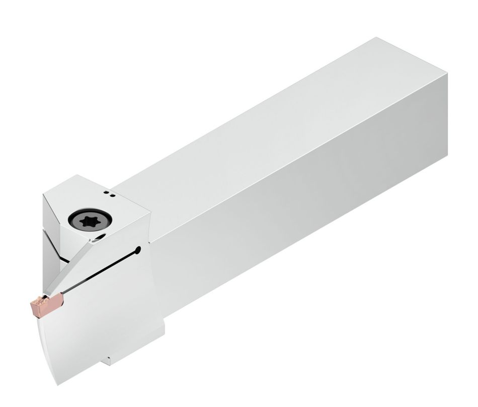

Drawings for 6116579
제품 번호6116579
ISO 카탈로그 IDEVSBR2525M0426100180C
ASI 카탈로그 IDEVSBR2525M0426100180C
Insert Size4
[CD] Cutting Depth 26 mm
[CD] Cutting Depth 1.024 in
[DM] Minimum Bore Diameter 100 mm
[DM] Minimum Bore Diameter 3.937 in
[DMAX] Maximum Bore Diameter180 mm
[DMAX] Maximum Bore Diameter7.087 in
[H1] Cutting Height25.01 mm
[H1] Cutting Height0.985 in
[H] Shank Height 25 mm
[H] Shank Height 0.984 in
[B] Shank Width 25 mm
[B] Shank Width 0.984 in
[H2] Head Height 34 mm
[H2] Head Height 1.339 in
[L1] Tool Length 150 mm
[L1] Tool Length 5.906 in
[FS] Secondary F Dimension 23.2 mm
[FS] Secondary F Dimension 0.913 in
[LH] Head Length 47 mm
[LH] Head Length 1.85 in
[CS] Coolant Supply Size1/8-27 NPTF
Clamp Screw ID Drive SizeT30
공작물 재료
사용 및 응용 분야
  • Through Coolant: GroovingThrough Coolant: Grooving
  • Cut-OffCut-Off
  • TurningTurning
  • ProfilingProfiling
  • FacingFacing
  • ChamferingChamfering
  • GroovingGrooving
