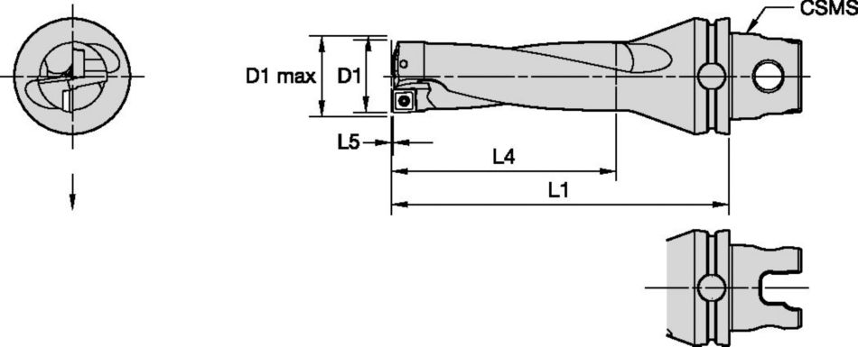

[CSMS] System Size Machine SideKM63XMZ
[D1] Drill Diameter M 47 mm
[D1] Drill Diameter M 1.8504 in
[D1MAX] Drill Diameter Maximum48 mm
[D1MAX] Drill Diameter Maximum1.8898 in
[L1] Insert Gage Length 196 mm
[L1] Insert Gage Length 7.7165 in
[L4] Maximum Drilling Depth 141 mm
[L4] Maximum Drilling Depth 5.5512 in
[L5] Drill Point Length1.167 mm
[L5] Drill Point Length0.046 in
Gage InsertSPPX15T5.
Gage Insert 2DFT0704.
