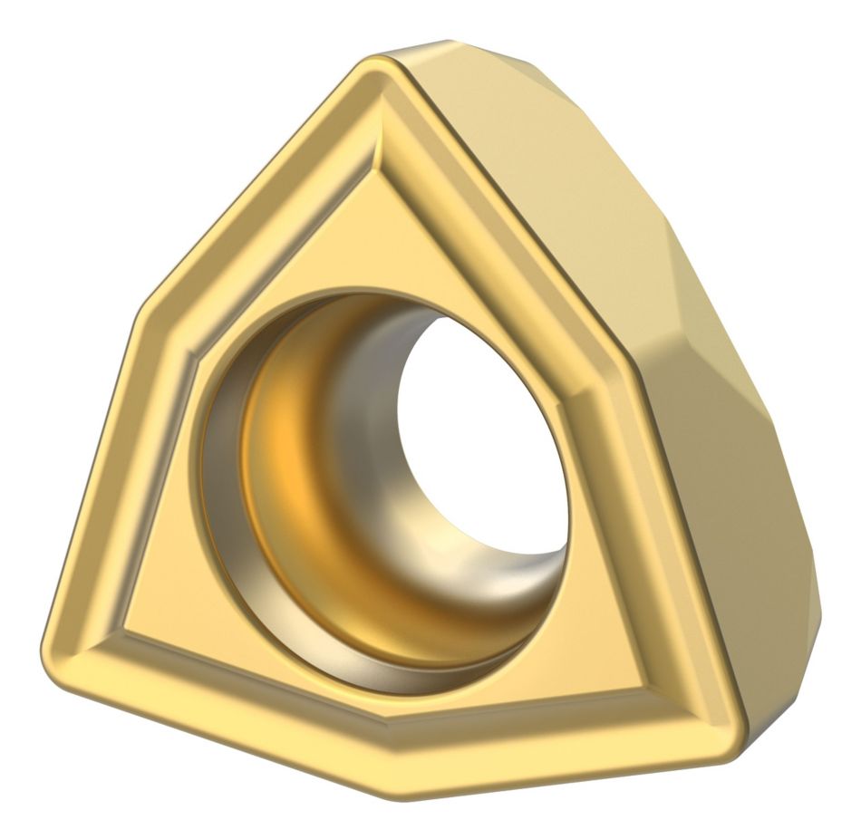

Drill Fix™ DFT™ • GD 인서트
제품 번호3044268
ISO 카탈로그 IDDFT030204GDASI 카탈로그 IDDFT030204GD
| 제품 번호 | 3044268 |
| ISO 카탈로그 ID | DFT030204GD |
| ASI 카탈로그 ID | DFT030204GD |
| Grade | KC7815 |
| [L10] Insert Cutting Edge Length | 3.97 mm |
| [L10] Insert Cutting Edge Length | 0.156 in |
| [D] Insert IC Size | 6 mm |
| [D] Insert IC Size | 0.236 in |
| [D1] Insert Hole Size | 2.25 mm |
| [D1] Insert Hole Size | 0.089 in |
| [S] Insert Thickness | 2.45 mm |
| [S] Insert Thickness | 0.096 in |
| [Rε] Corner Radius | 0.4 mm |
| [Rε] Corner Radius | 0.016 in |
재종
KC7815
Multi-Layered MT-CVD TiCN-Al203 coating
Designed for indexable drilling of alloyed steels and some cast irons
Superior performance when drilling ferrous steels at elevated speeds
Expect 100% improvement in tool life versus competitive grades
Use KC7815 in outboard pockets, KC7140 in inboard pockets for optimum performance with DRILL-FIX bodies
Geometry: GD with honed negative land provides added strength
특징 및 장점
- General purpose chipbreaker geometry preferred on normal chipping materials and cast iron at high feed rates
