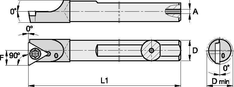

[D] Adapter / Shank / Bore Diameter6.34 mm
[D] Adapter / Shank / Bore Diameter0.25 in
[DM] Minimum Bore Diameter 7.52 mm
[DM] Minimum Bore Diameter 0.296 in
[F] F Dimension 3.96 mm
[F] F Dimension 0.156 in
[L1] Tool Length 101.6 mm
[L1] Tool Length 4 in
[L] Overall Length 101.6 mm
[L] Overall Length 4 in
[A] Coolant Hole Diameter 1.19 mm
[A] Coolant Hole Dia 0.047 in
[A1] Coolant Hole Diameter Exit 1.19 mm
[A1] Coolant Hole Diameter Exit 0.047 in
Gage InsertTD..130805
Insert Screw ID Drive SizeT7
