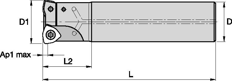

[D1] Effective Cutting Diameter | 19.05 mm |
[D1] Effective Cutting Diameter | 0.75 in |
[D] Adapter / Shank / Bore Diameter | 19.05 mm |
[D] Adapter / Shank / Bore Diameter | 0.75 in |
[L] Overall Length | 140.8 mm |
[L] Overall Length | 5.543 in |
[L2] Head Length | 50.8 mm |
[L2] Head Length | 2 in |
[AP1MAX] 1st Maximum Cutting Depth | 1.016 mm |
[AP1MAX] 1st Maximum Cutting Depth | 0.04 in |
Number of Inserts | 2 |
Maximum Ramping Angle | 10.8 |
Gage Insert | WP..05X3. |
Weight Pounds | 0.55 |
