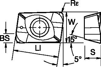

Drawings for 1157449
제품 번호1157449
ISO 카탈로그 IDADPT1035PDERGP
ANSI 카탈로그 IDADPT1622PDER5GP
GradeKC725M
[LI] Insert Length 10 mm
[LI] Insert Length 0.3937 in
[S] Insert Thickness3.5 mm
[S] Insert Thickness0.1378 in
[W] Insert Width 6.7 mm
[W] Insert Width 0.264 in
[BS] Corner Facet Length 2.16 mm
[BS] Corner Facet Length 0.085 in
[Rε] Corner Radius 0.8 mm
[Rε] Corner Radius 0.031 in
Average Chip Thickness [HM]0.051 mm
Average Chip Thickness [HM]0.002 in
Cutting Edges per Insert2
