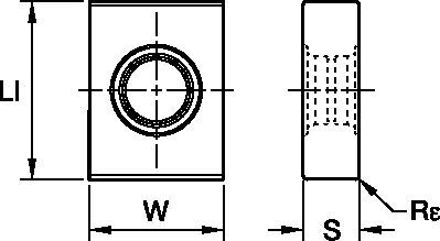

Drawings for 6993263
제품 번호6993263
ISO 카탈로그 IDLNEU1245R08
ANSI 카탈로그 IDLNEU1245R08
GradeKCK20B
[LI] Insert Length 12.7 mm
[LI] Insert Length 0.5 in
[S] Insert Thickness4.5 mm
[S] Insert Thickness0.177 in
[W] Insert Width 9.52 mm
[W] Insert Width 0.375 in
[Rε] Corner Radius 0.8 mm
[Rε] Corner Radius 0.031 in
Cutting Edges per Insert4
