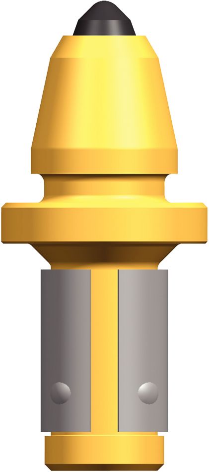

SD06
22mm Shank Conicals • SD Series
제품 번호2504867
ISO 카탈로그 IDSD06ASI 카탈로그 IDSD06
SD06 Trenching - 2504867 - Kennametal

GradeK3560MH
[D] Shank/Bore Diameter21.971 mm
[D] Shank/Bore Diameter0.865 in
[D2] Body Diameter Workpiece Side38.1 mm
[D2] Body Diameter Workpiece Side1.5 in
[L1] Gage Length45.25 mm
[L1] Gage Length1.7815 in
[LRO] Retainer Offset Length35.509 mm
[LRO] Retainer Offset Length1.398 in
[LS] Shank Length 41.91 mm
[LS] Shank Length 1.65 in
[OAL] Overall Length87.16 mm
[OAL] Overall Length3.4315 in
[TD] Tip Diameter12.014 mm
[TD] Tip Diameter0.473 in
[TL] Tip Length17.805 mm
[TL] Tip Length0.701 in
Cutting ConditionMEDIUM
기계 전원medium to high
리테이너 스타일FRICTION POSITIVE LOCK
[TDS] Tip Diameter Start15.304 mm
[TDS] Tip Diameter Start0.6025 in
