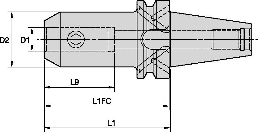

Drawings for 3856577
Material Number3856577
ISO Catalog IDBTKV50BEM200550
ANSI Catalog IDBTKV50BEM200550
[D2] Body Diameter 1 Workpiece Side 95.25 mm
[D2] Body Diameter 1 Workpiece Side 3.75 in
[L1] Gage Length139.7 mm
[L1] Gage Length5.5 in
Gage Length Face Contact [L1FC]138.2 mm
Gage Length Face Contact [L1FC]5.4409 in
Clamp Screw ID Drive Size1/2
Torque Foot Pounds148
Weight Pounds16.28
[D1] Adapter / Shank / Bore Diameter50.8 mm
[D1] Adapter / Shank / Bore Diameter2 in
  • Shank - Cylindrical Weldon 2 FlatShank - Cylindrical Weldon 2 Flat
  • Balance - G 6.3@15,000 min-1Balance - G 6.3@15,000 min-1
  • Shank - Cylindrical Weldon DIN 1835/BShank - Cylindrical Weldon DIN 1835/B
  • Shank - SK BT Taper Face ContactShank - SK BT Taper Face Contact
