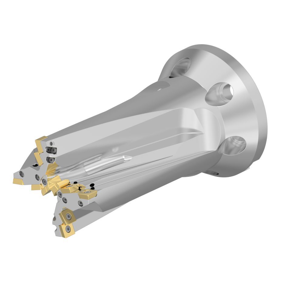

| Material Number | 7228296 |
| ISO Catalog ID | KSEMX7501FBX150BTF46M |
| ANSI Catalog ID | KSEMX7501FBX150BTF46M |
| [D1] Drill Diameter M | 75 mm |
| [D1] Drill Diameter M | 2.9528 in |
| [PDD] Pilot Drill Cut Diameter | 32 mm |
| [PDD] Pilot Drill Cut Diameter | 1.2598 in |
| [PPL] Pilot Protrusion Length | 0.2 mm |
| [PPL] Pilot Protrusion Length | 0 in |
| [L1] Insert Gage Length | 215 mm |
| [L1] Insert Gage Length | 8.4646 in |
| [L4] Maximum Drilling Depth | 150 mm |
| [L4] Maximum Drilling Depth | 5.9055 in |
| [D5] Maximum Body Diameter | 117.475 mm |
| [D5] Maximum Body Diameter | 4.625 in |
| [SSC] Insert Seat Size | 8 |

- Advanced drill body design for flat bottom drilling and plunging
- Two effective cutting edges in the center for maximum feed
- Four effective cutting edges on the outer diameter for highest productivity on plunging operations
- Interchangeable coolant nozzles in different sizes for optimized heat control
- Four flutes for reliable chip evacuation and highest tool stiffness
- BTF taper flange connection for maximum stability and flexibility
- Use the pocket seat size SSC to select a suitable center insert
