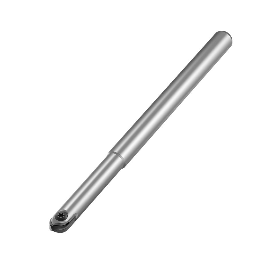

KDMB™ • End Mill • Cylindrical Shank • Carbide • Necked • Metric
Indexable Ball Nose Finisher
Material Number2877383
ISO Catalog IDKDMB32R240A32HNCANSI Catalog IDKDMB32R240A32HNC
- P Steel
- M Stainless Steel
- K Cast Iron
- N Non-Ferrous
- S High-Temp Alloys
- H Hardened Materials
- .caption
Ramping: Blank
Slotting: Ball Nose
Side Milling/Shoulder Milling: Ball Nose
3D Profiling
Shank - Cylindrical Plain
Pocketing
- Overview
- Application Data
- Downloads
- Spare Parts
| Material Number | 2877383 |
| ISO Catalog ID | KDMB32R240A32HNC |
| ANSI Catalog ID | KDMB32R240A32HNC |
| [D1] Effective Cutting Diameter | 32 mm |
| [D1] Effective Cutting Diameter | 1.26 in |
| [D] Adapter / Shank / Bore Diameter | 32 mm |
| [D] Adapter / Shank / Bore Diameter | 1.2598 in |
| [D3] Neck Diameter | 28.6 mm |
| [D3] Neck Diameter | 1.126 in |
| [L2] Head Length | 105 mm |
| [L2] Head Length | 4.1339 in |
| [L] Overall Length | 240 mm |
| [L] Overall Length | 9.449 in |
| [L1] Gage Length | 240 mm |
| [L1] Gage Length | 9.449 in |
| [AP1MAX] 1st Maximum Cutting Depth | 16 mm |
| [AP1MAX] 1st Maximum Cutting Depth | 0.6299 in |
| Number of Inserts | 1 |
| [Z] Number of Flutes | 2 |
| Coolant Supply | Y |
| Maximum Ramping Angle | 3 |
| Max RPM | 30000 |
| Gage Insert | KDMB32. |
