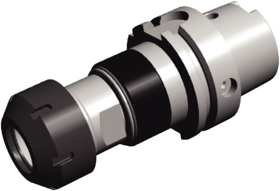

RC Solid Tap Adapters
RC-Style Solid Tap Adapters
Material Number1179207
ISO Catalog IDRC3TA110090M140ANSI Catalog IDRC3TA110090M140
Quick-Change Tap Adapters RC3-Style Solid Tap Adapters
$293.21/each
  • Tapping - Through Coolant 50 bar (725 psi) MaximumTapping - Through Coolant 50 bar (725 psi) Maximum
Drawings for 1179207
Tap Range DINM14
[D1] Adapter / Shank / Bore Diameter11 mm
[D1] Adapter / Shank / Bore Diameter0.433 in
[S10] Square Size 9 mm
[S10] Square Size 0.354 in
  • Rapid Change style.
  • Solid-positive drive.
  • Coolant capability by using cutting tool with coolant feature.
  • For taps with DIN, ISO, and ANSI specifications.
TC • Tension and Compression
1126272
KM63TSTC3147M
KM63TSTC3147M
RC-BT form A
