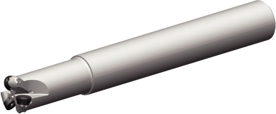

7713VR10 Series • End Mill • Cylindrical Shank • Inch
Copy/Contour Milling Cutter
Material Number5672803
ISO Catalog IDC7713VR10CA1.00Z3R2.0ANSI Catalog IDC7713VR10CA1.00Z3R2.0
- P Steel
- M Stainless Steel
- K Cast Iron
- N Non-Ferrous
- S High-Temp Alloys
- H Hardened Materials
- .caption
Spiral Circular
Face Milling
Helical Milling
Ramping: Blank
Shank - Cylindrical Plain
Milling - Through Coolant
Pocketing
Counter Boring
Inclined Square End Mill
- Overview
- Application Data
- Downloads
- Spare Parts
| Material Number | 5672803 |
| ISO Catalog ID | C7713VR10CA1.00Z3R2.0 |
| ANSI Catalog ID | C7713VR10CA1.00Z3R2.0 |
| [D1MAX] Maximum Cutting Diameter | 25.4 mm |
| [D1MAX] Maximum Cutting Diameter | 1 in |
| [D1] Effective Cutting Diameter | 15.4 mm |
| [D1] Effective Cutting Diameter | 0.6063 in |
| [D] Adapter / Shank / Bore Diameter | 25.4 mm |
| [D] Adapter / Shank / Bore Diameter | 1 in |
| [L] Overall Length | 200 mm |
| [L] Overall Length | 7.874 in |
| [L2] Head Length | 50 mm |
| [L2] Head Length | 1.9685 in |
| [AP1MAX] 1st Maximum Cutting Depth | 5 mm |
| [AP1MAX] 1st Maximum Cutting Depth | 0.1969 in |
| Number of Inserts | 3 |

- Turbine blade machining and copy/contour milling applications.
- Patented locking system prevents insert rotation during heavy machining.
- Positive flute design for excellent chip evacuation.
