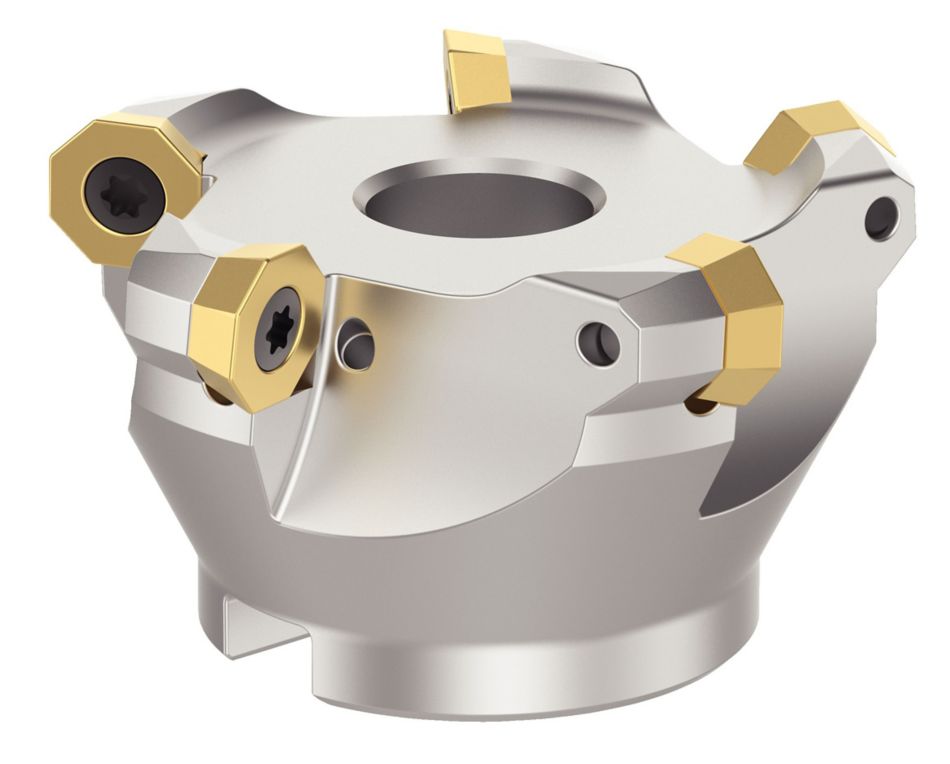

7745VOD04 Series • Shell Mill • Metric
Face milling cutter for multiple materials.
Material Number5672039
ISO Catalog ID7745VOD04-A125Z12RANSI Catalog ID7745VOD04-A125Z12R

  • Face MillingFace Milling
Drawings for 5672039
[D1MAX] Maximum Cutting Diameter133 mm
[D1MAX] Maximum Cutting Diameter5.236 in
[D1] Effective Cutting Diameter125 mm
[D1] Effective Cutting Diameter4.921 in
[D] Adapter / Shank / Bore Diameter1.575 in
[L] Overall Length 63 mm
[L] Overall Length 2.48 in
[AP1MAX] 1st Maximum Cutting Depth3.5 mm
[AP1MAX] 1st Maximum Cutting Depth0.1378 in
[AP2MAX] 2nd Maximum Cutting Depth8 mm
[AP2MAX] 2nd Maximum Cutting Depth0.315 in
Number of Inserts12
Max RPM15700
