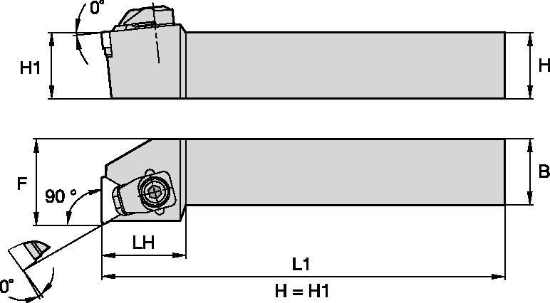

Drawings for 1510344
Material Number1510344
ISO Catalog IDCTFNR2525M16-MN4
ANSI Catalog IDCTFNR2525M16-MN4
[H] Shank Height 25 mm
[H] Shank Height 0.9843 in
[B] Shank Width 25 mm
[B] Shank Width 0.9843 in
[F] F Dimension 32 mm
[F] F Dimension 1.2598 in
[L1] Tool Length 150 mm
[L1] Tool Length 5.9055 in
[LH] Head Length 29 mm
[LH] Head Length 1.1417 in
Gage InsertTN.N160408
Shim Screw ID Drive Size2.5 mm
Clamp Screw ID Drive Size4 mm
