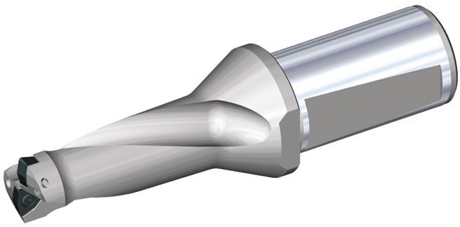

DFT Whistle Notch WD Shank • 2.5 x D
Drill Fix™ DFT™ Bodies
Material Number1543236
ISO Catalog IDDFT740R2WD50MANSI Catalog IDDFT740R2WD50M

| Material Number | 1543236 |
| ISO Catalog ID | DFT740R2WD50M |
| ANSI Catalog ID | DFT740R2WD50M |
| [D] Adapter / Shank / Bore Diameter | 50 mm |
| [D] Adapter / Shank / Bore Diameter | 1.9685 in |
| [D1] Drill Diameter M | 74 mm |
| [D1] Drill Diameter M | 2.9134 in |
| [D1MAX] Drill Diameter Maximum | 75 mm |
| [D1MAX] Drill Diameter Maximum | 2.9528 in |
| [L1] Insert Gage Length | 205 mm |
| [L1] Insert Gage Length | 8.0709 in |
| [L4] Maximum Drilling Depth | 140 mm |
| [L4] Maximum Drilling Depth | 5.5118 in |
| [L5] Drill Point Length | 3.94 mm |
| [L5] Drill Point Length | 0.1551 in |
| Gage Insert | DFT1105. |
