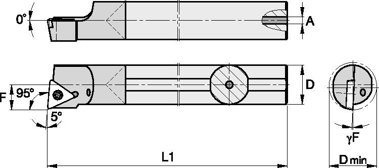

Drawings for 1152769
Material Number1152769
ISO Catalog IDE08STLPR2
ANSI Catalog IDE08STLPR2
GradeKWH
[D] Adapter / Shank / Bore Diameter12.7 mm
[D] Adapter / Shank / Bore Diameter0.5 in
[DM] Minimum Bore Diameter 15.24 mm
[DM] Minimum Bore Diameter 0.6 in
[F] F Dimension 7.925 mm
[F] F Dimension 0.312 in
[L1] Tool Length 203.2 mm
[L1] Tool Length 8 in
[L] Overall Length 203.2 mm
[L] Overall Length 8 in
[A] Coolant Hole Diameter 4.75 mm
[A] Coolant Hole Dia 0.187 in
Gage InsertTP..2151
Insert Screw ID Drive SizeT7
