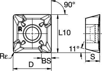

Drawings for 2383587
Material Number2383587
ISO Catalog IDSPCT10T312PPERLD2
ANSI Catalog IDSPCT31253PPER8LD2
GradeKC725M
[D] Insert IC Size10 mm
[D] Insert IC Size0.394 in
[D1] Insert Hole Size 3.4 mm
[D1] Insert Hole Size 0.134 in
[S] Insert Thickness3.969 mm
[S] Insert Thickness0.1562 in
[L10] Insert Cutting Edge Length10 mm
[L10] Insert Cutting Edge Length0.394 in
[BS] Corner Facet Length 2.7 mm
[BS] Corner Facet Length 0.106 in
[Rε] Corner Radius 1.2 mm
[Rε] Corner Radius 0.047 in
Average Chip Thickness [HM]0.038 mm
Average Chip Thickness [HM]0.0015 in
Cutting Edges per Insert4
