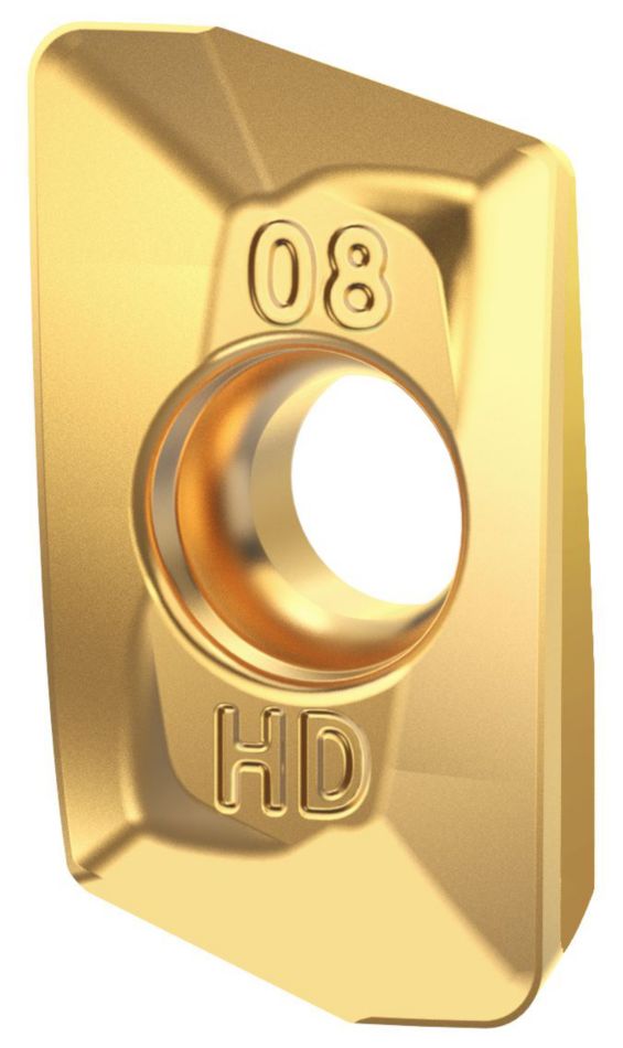

Mill 1-10™ • Carbide Insert • EDPT-HD • Heavy Machining
Shoulder milling insert with two cutting edges per insert
Material Number6175758
ISO Catalog IDEDPT10T316PDERHDANSI Catalog IDEP1016EHD
GradeKCSM40
[LI] Insert Length 12.06 mm
[LI] Insert Length 0.475 in
[S] Insert Thickness3.75 mm
[S] Insert Thickness0.148 in
[W] Insert Width 6.74 mm
[W] Insert Width 0.265 in
[BS] Corner Facet Length 0.9 mm
[BS] Corner Facet Length 0.036 in
[Rε] Corner Radius 1.6 mm
[Rε] Corner Radius 0.063 in
Average Chip Thickness [HM]0.082 mm
Average Chip Thickness [HM]0.0032 in
Cutting Edges per Insert2
KCSM40
KCSM40
  • Pressed-to-size, for lowest cost per cutting edge.
