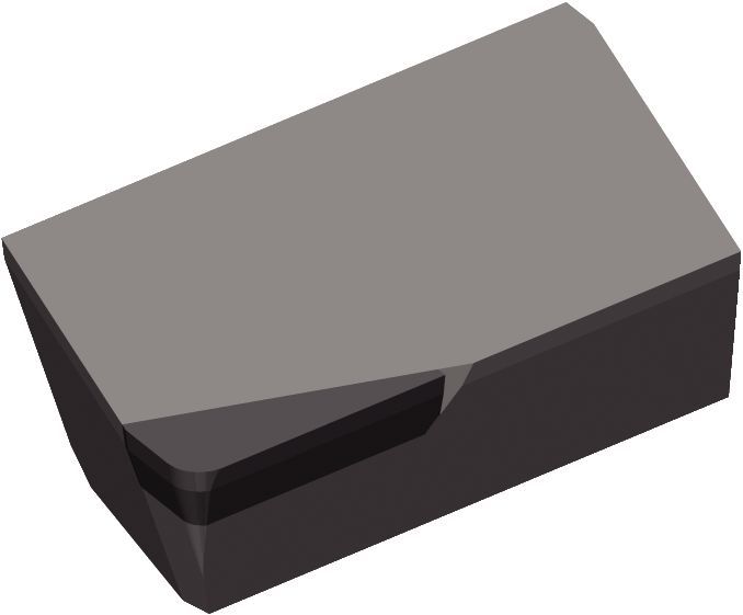

KBDM Series • PCD-Tipped Carbide Insert • KSDR-E1 • Highspeed Machining
Face milling insert with one cutting edge, precision ground.
Material Number6042988
ISO Catalog IDKSDR100093E1W4SANSI Catalog IDKSDR100093E1W4S
PCD Inserts KSDR E1 6042988 KSDR100093E1W4S - Kennametal.com
$121.91/each
Drawings for 6042988
GradeKD1400
[W] Insert Width 9.52 mm
[W] Insert Width 0.375 in
[BS] Corner Facet Length 1.52 mm
[BS] Corner Facet Length 0.06 in
[Rε] Corner Radius 2.4 mm
[Rε] Corner Radius 0.094 in
Average Chip Thickness [HM]0.02 mm
Average Chip Thickness [HM]0.0008 in
KD1400
KD1400
A PCD-tip brazed to a carbide carrier for high-speed machining of non-ferrous materials. KD1400 has excellent chipping resistance with good wear characteristics. Coolant is preferred.
  • Precision ground insert for best run-out and surface finish.
  • Milling insert for aluminum and non-ferrous materials machining.
  • Patented locking mechanism guarantees secure insert seating at high RPM's.
  • Embedded wiper facet for increased surface finish quality.
  • Up to Ap1=6.3mm/.245"
