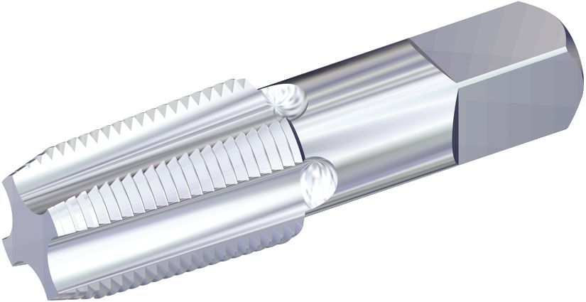

KHSST High Hook Taper Pipe • Standard Pipe Chamfer 2 1/2 to 3 1/2 Pitches
NPT/ANPT High-Hook Production Taper Pipe Taps

  • Taraudage : filetage de tubeTaraudage : filetage de tube
  • Acier rapideAcier rapide
  • Arrosage externe : TaraudageArrosage externe : Taraudage
  • Spécifications fabricant : NPTSpécifications fabricant : NPT

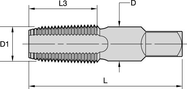

Numéro de matériel4130810
Ref. ISO CatalogueKHSST28174
Ref. ANSI CatalogueKHSST28174
RevêtementUncoated
[D1-TDZ] Taille du diamètre de filetage3/4 - 14
[L] Longueur totale 82.55 mm
[L] Longueur totale 3.25 in
[L3] Longueur du filet 34.925 mm
[L3] Longueur du filet 1.375 in
[D] Adaptateur / Queue / Diamètre d’alésage23.012 mm
[D] Adaptateur / Queue / Diamètre d’alésage0.906 in
[Z] Nombre de goujures5
Type de filetsNPT/ANPT

  • Manufactured from select high-speed steel.
  • Ground thread pipe taps are standard in American Standard Pipe Form (NPT).
  • NPT threads require the use of a sealer, such as Teflon® tape or pipe compound.
  • Uncoated taps standard; coatings available as specials.
  • Hook designed for use in ductile materials that produce long, continuous chips.
