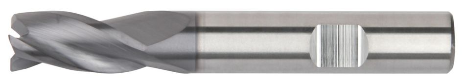

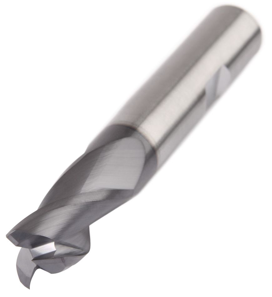

GOmill™ GP • Chamfered • 3 Flutes • Weldon® Shank • Metric
General Purpose Solid Carbide End Mill
Material Number6146973
ISO Catalog ID3CH2000DL032BANSI Catalog ID3CH2000DL032B

  • DIN number 6527DIN number 6527
  • Tool Dimensions: Flute Configuration: 3Tool Dimensions: Flute Configuration: 3
Drawings for 6146973
GradeKC633M
Adapter Style Machine SideWeldon
[D1] Effective Cutting Diameter20 mm
[D1] Effective Cutting Diameter0.7874 in
[D] Adapter / Shank / Bore Diameter20 mm
[D] Adapter / Shank / Bore Diameter0.7874 in
[AP1MAX] 1st Maximum Cutting Depth32 mm
[AP1MAX] 1st Maximum Cutting Depth1.2598 in
[L] Overall Length 104 mm
[L] Overall Length 4.0945 in
[BCH] Corner Chamfer Width 0.3 mm
[BCH] Corner Chamfer Width 0.0118 in
[Z] Number of Flutes3
KC633M
KC633M
Coated carbide grade with PVD multilayer coating. KC633M™ is designed for dry milling most types of material, apart from the hardened variety. This grade is characterized by high hardness and wear resistance. It provides outstanding protection for solid carbide tools against cratering and abrasion.
  • Solid carbide end mill with stepped parallel shank according to DIN 6527
  • Solid carbide end mill with excellent cost-benefit ratio
  • Eccentric relief increases cutting edge stability for long tool life and high surface quality
  • Eccentric relief eases regrinding and reduces reconditioning cost
