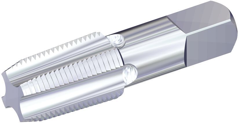

KHSST Taper Pipe • Chamfer 2 1/2 to 3 1/2 Pitches
NPT/ANPT and NPTF Production Taper Pipe Taps
Material Number4130755
ISO Catalog IDKHSST28139ANSI Catalog IDKHSST28139
$83.27/each
  • Tapping: Pipe ThreadTapping: Pipe Thread
  • HSSHSS
  • Manufacturer’s Specs: NPTManufacturer’s Specs: NPT
  • Manufacturer’s Specs: NPTFManufacturer’s Specs: NPTF
Drawings for 4130755
CoatingTiN
[D1-TDZ] Thread Diameter Size1/8 - 27
[L] Overall Length 53.975 mm
[L] Overall Length 2.125 in
[L3] Thread Length 19.05 mm
[L3] Thread Length 0.75 in
[D] Adapter / Shank / Bore Diameter11.113 mm
[D] Adapter / Shank / Bore Diameter0.4375 in
[Z] Number of Flutes4
Type of ThreadNPT/ANPT
  • HSSHSS
  • Manufactured from select high-speed steel.
  • Ground thread pipe taps are standard in American Standard Pipe Form (NPT) and American Standard Dryseal Pipe Thread Form (NPTF).
  • NPT threads require the use of a sealer, such as Teflon® tape or pipe compound.
  • NPTF dryseal threads give a pressure-tight joint without the use of sealer.
  • The nominal size of a pipe tap is that of the pipe fitting to be tapped, not the actual size of the tap; thread taper is 3/4" per foot.
  • Alternate tap coatings are available as stock modifications.
