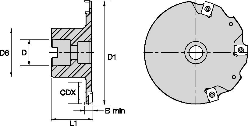

  • Slotting: Side with AE/AP dimensionsSlotting: Side with AE/AP dimensions
Drawings for 1130506
Material Number1130506
ISO Catalog ID125Y12RS90LN12N10
ANSI Catalog ID125Y12RS90LN12N10
[D1] Effective Cutting Diameter125 mm
[D1] Effective Cutting Diameter4.9213 in
[D] Adapter / Shank / Bore Diameter1.5748 in
[D6] Hub Diameter 70 mm
[D6] Hub Diameter 2.7559 in
[BM] Cutting Width Minimum10 mm
[BM] Cutting Width Minimum0.3937 in
[CDX] Radial Maximum Depth of Cut26 mm
[CDX] Radial Maximum Depth of Cut1.0236 in
[L1] Gage Length50 mm
[L1] Gage Length1.969 in
Number of Inserts12
[Z] Number of Flutes4
Gage InsertLNE_1245___
  • Easy cutting width adjustment through inserts with different thickness.
  • Right-hand and full-side cutting versions.
  • Base slot angle of 2°.
  • Maximum slot width tolerance: +/- 0,05mm.
