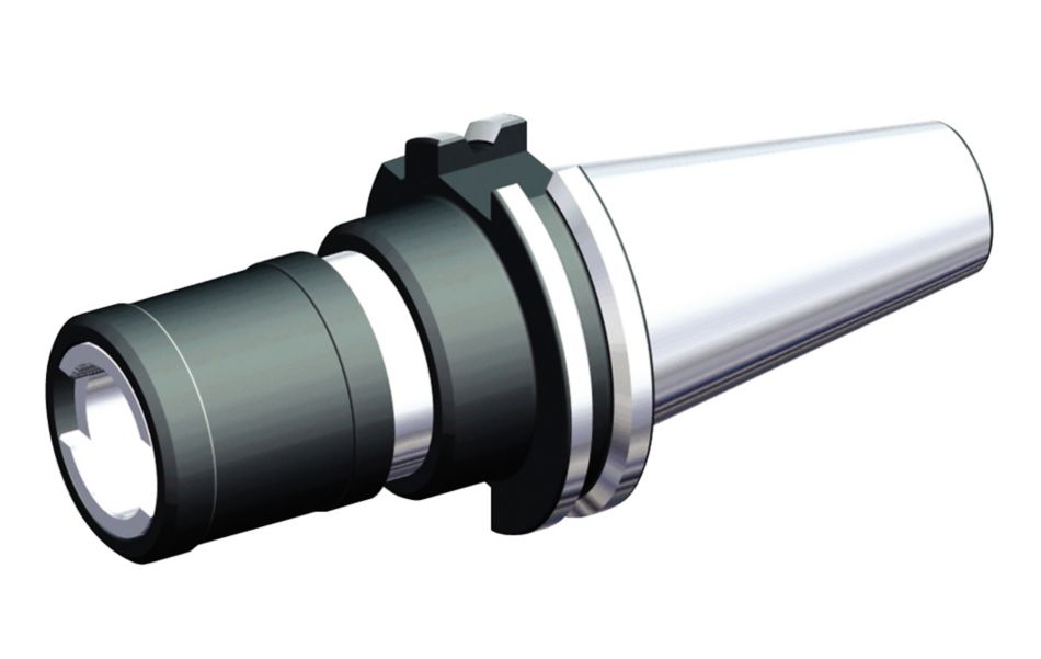

RC-DV Form A
Tap Chucks RC Tension and Compression • Solid
Material Number1777397
ISO Catalog IDDV40RC1060MANSI Catalog IDDV40RC1060M
DV Shank Tools Tap Chucks RC Tension and Compression
$535.29/each
  • Shank - M16 DrawbarShank - M16 Drawbar
  • Compensation: Tension and CompressionCompensation: Tension and Compression
  • Shank - SK DV DIN 69871Shank - SK DV DIN 69871
  • Coolant - No CoolantCoolant - No Coolant
Drawings for 1777397
[TQCS] Tap Quick Change Size1
Tap Range M1 - M14 mm
Tap Range #0 - 9/16 in
[D1] Adapter / Shank / Bore Diameter19 mm
[D1] Adapter / Shank / Bore Diameter0.748 in
[D2] Body Diameter 1 Workpiece Side 36 mm
[D2] Body Diameter 1 Workpiece Side 1.417 in
[L1] Gage Length60 mm
[L1] Gage Length2.3622 in
[LTN] Slide Tension 7.5 mm
[LTN] Slide Tension 0.2953 in
[LCM] Slide Compression 7.5 mm
[LCM] Slide Compression 0.2953 in
Weight Kilograms1.8
