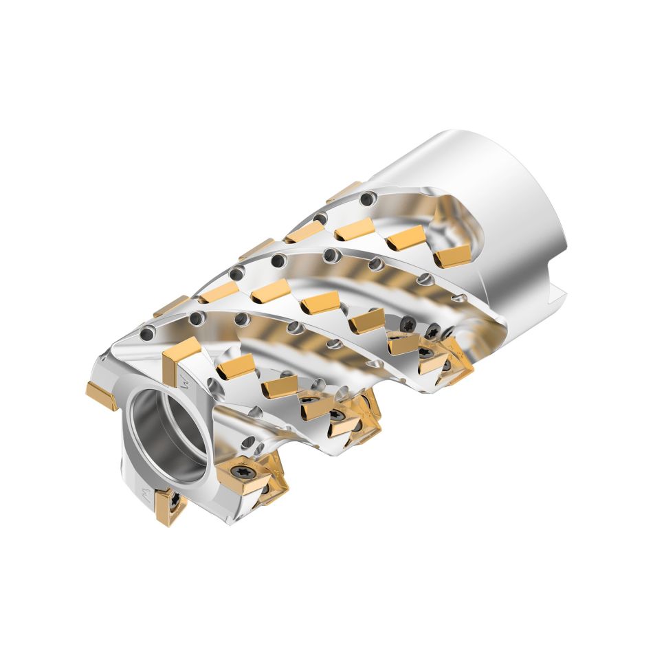

5230VS12 Series • Helical Shell Mill • Metric
Shoulder milling cutter for multiple materials.
Material Number5673169
ISO Catalog ID5230VS12-A100Z6R133ANSI Catalog ID5230VS12-A100Z6R133

  • Slotting: Shoulder ProfilingSlotting: Shoulder Profiling
Drawings for 5673169
[D1] Effective Cutting Diameter100 mm
[D1] Effective Cutting Diameter3.9369 in
[D] Adapter / Shank / Bore Diameter1.5748 in
[D6] Hub Diameter 94 mm
[D6] Hub Diameter 3.7008 in
[L] Overall Length 165 mm
[L] Overall Length 6.4961 in
[AP1MAX] 1st Maximum Cutting Depth133 mm
[AP1MAX] 1st Maximum Cutting Depth5.2362 in
Number of Inserts84
[Z] Number of Flutes6
  • Adjustable coolant nozzles support chip evacuation and control heat in the cutting zone.
  • Insert positioning provides smooth cutting action, resulting in lower power consumption.
  • Well suited for titanium and high-temperature alloy machining.
