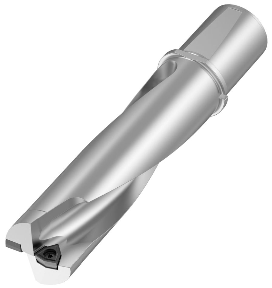

DFSP Whistle Notch WD Shank • 3 x D
Drill Fix™ DFSP™ Bodies
Material Number5691864
ISO Catalog IDDFSP265R3WD32MANSI Catalog IDDFSP265R3WD32M
- P Steel
- M Stainless Steel
- K Cast Iron
- N Non-Ferrous
- S High-Temp Alloys
- .caption
Drilling
Drilling: Inclined Entry
Drilling: Inclined Exit
Drilling: X-Offset
Drilling: Convex
Shank - Cylindrical Whistle Notch with Drive and Flange
Through Coolant: Radial: Indexable Drilling
Drilling: Blind
Chain Drilling
Drilling: Cross-Hole Drilling
Drilling: Corner Drilling 45°
- Overview
- Application Data
- Downloads
- Spare Parts
| Material Number | 5691864 |
| ISO Catalog ID | DFSP265R3WD32M |
| ANSI Catalog ID | DFSP265R3WD32M |
| [D] Adapter / Shank / Bore Diameter | 32 mm |
| [D] Adapter / Shank / Bore Diameter | 1.2598 in |
| [D1] Drill Diameter M | 26.5 mm |
| [D1] Drill Diameter M | 1.0433 in |
| [D1MAX] Drill Diameter Maximum | 27.5 mm |
| [D1MAX] Drill Diameter Maximum | 1.0827 in |
| [L1] Insert Gage Length | 113.5 mm |
| [L1] Insert Gage Length | 4.4685 in |
| [L4] Maximum Drilling Depth | 79.5 mm |
| [L4] Maximum Drilling Depth | 3.1299 in |
| [L5] Drill Point Length | 0.73 mm |
| [L5] Drill Point Length | 0.0287 in |
| [LS] Shank Length | 58 mm |
| [LS] Shank Length | 2.2835 in |
| [CS] Coolant Supply Size | R1/4 |
| Gage Insert | SPPX09T3. |
| Gage Insert 2 | DFT05T3. |
- Steel
- Stainless Steel
- Cast Iron
- Non-Ferrous
- High-Temp Alloys
- .caption
Drilling
Drilling: X-Offset
Drilling: Convex
Drilling: Blind
Chain Drilling
- DFSP combines the economical squared outboard insert with the superior centering capabilities of the trigon inboard insert
- Drill shipped with insert screws and Torx wrench
- Order DFSP inserts separately
