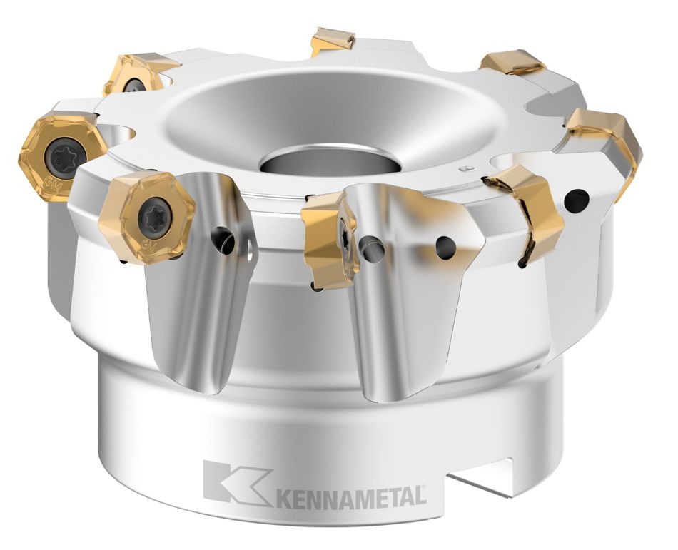

Dodeka™ Mini 60° • Shell Mill • Heavy Machining • Metric
Face milling cutter for multiple materials
Material Number4147715
ISO Catalog IDKSHR050A05RS60HN06ANSI Catalog IDKSHR050A05RS60HN06
- P Steel
- M Stainless Steel
- K Cast Iron
- N Non-Ferrous
- S High-Temp Alloys
- H Hardened Materials
- .caption
Face Milling
Side Milling/Shoulder Milling: Eased Chamfer
Milling - Through Coolant
Milling - Side and Face
- Overview
- Application Data
- Downloads
- Spare Parts
| Material Number | 4147715 |
| ISO Catalog ID | KSHR050A05RS60HN06 |
| ANSI Catalog ID | KSHR050A05RS60HN06 |
| [D1] Effective Cutting Diameter | 50 mm |
| [D1] Effective Cutting Diameter | 1.969 in |
| [D1MAX] Maximum Cutting Diameter | 56.35 mm |
| [D1MAX] Maximum Cutting Diameter | 2.218 in |
| [D] Adapter / Shank / Bore Diameter | 22 mm |
| [D] Adapter / Shank / Bore Diameter | 0.8661 in |
| [D6] Hub Diameter | 38 mm |
| [D6] Hub Diameter | 1.496 in |
| [L] Overall Length | 40 mm |
| [L] Overall Length | 1.575 in |
| [AP1MAX] 1st Maximum Cutting Depth | 4.3 mm |
| [AP1MAX] 1st Maximum Cutting Depth | 0.171 in |
| Number of Inserts | 5 |
| Weight Kilograms | 0.32 |
| Max RPM | 12700 |
