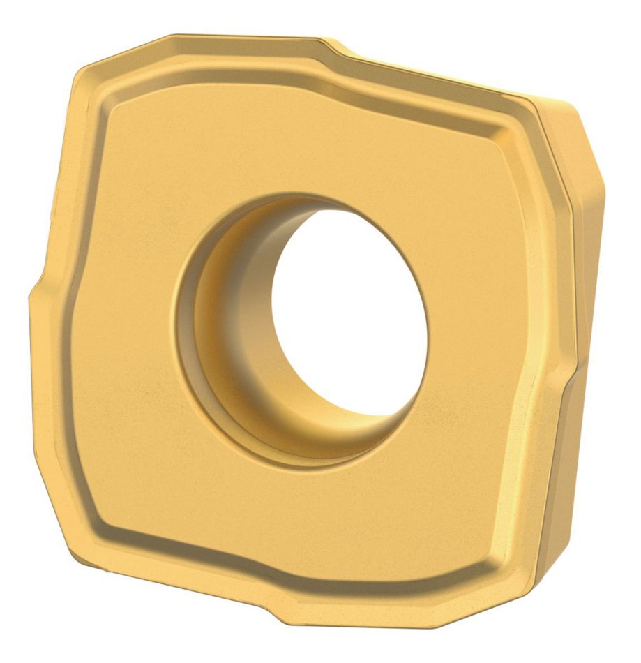

Drill Fix PRO™ • Carbide Insert • Inboard • MS Geometry
Drilling insert for Stainless Steel and Steel
Material Number7034352
ISO Catalog IDDFPR170508MSIANSI Catalog IDDFPR170508MSI
- P Steel
- M Stainless Steel
- N Non-Ferrous
- S High-Temp Alloys
Drilling
Drilling: Inclined Entry
Drilling: Inclined Exit
Drilling: X-Offset
Drilling: Stacked Plates
Drilling: Convex
Drilling: Blind
Chain Drilling
Drilling: Cross-Hole Drilling
Drilling: Corner Drilling 45°
| Material Number | 7034352 |
| ISO Catalog ID | DFPR170508MSI |
| ANSI Catalog ID | DFPR170508MSI |
| Grade | KC7140 |
| [D1] Insert Hole Size | 6.05 mm |
| [D1] Insert Hole Size | 0.238 in |
| [D] Insert IC Size | 17.3 mm |
| [D] Insert IC Size | 0.681 in |
| [RR] Corner Radius | 0.8 mm |
| [RR] Corner Radius | 0.031 in |
| [W] Cutting Width | 14.35 mm |
| [W] Cutting Width | 0.565 in |
| [S] Insert Thickness | 5.2 mm |
| [S] Insert Thickness | 0.205 in |

KC7140
Composition: PVD TiCN/TiN coated medium-grain carbide with high toughness.
Application: Best suited for machining of steel and stainless steel. This exceptionally tough grade is perfectly suited for metastable machining conditions offering excellent tool life.
- Four true cutting edges for lowest cost per part.
- Inboard Insert with unique nose-profile for best positioning accuracy.
