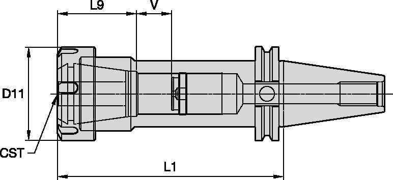

Material Number1261618
ISO Catalog IDCV40ER20250
ANSI Catalog IDCV40ER20250
[CST] Catalog Collet SeriesER20
[D11] Lock Nut Diameter35 mm
[D11] Lock Nut Diameter1.378 in
[L1] Gage Length63.5 mm
[L1] Gage Length2.5 in
[L9] Clamping Length 36 mm
[L9] Clamping Hole Length 1.42 in
[V] Adjustment Range 44 mm
[V] Adjustment Range 1.73 in
Weight Pounds2.37
Counter Bore Collet Torque InLb288
Straight Collet Torque In.Lbs.708
Stop Screw ID Drive Size4 mm & 5/32
