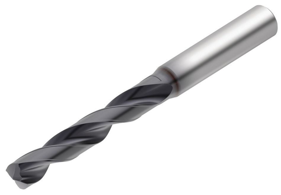

Kenna Universal™ Drill • 5 x D • Straight Shank • Metric
Solid Carbide Drill for Universal Applications
Material Number2425000
ISO Catalog IDB967A09000ANSI Catalog IDB967A09000
B967A 5xD Holemaking - 2425000 - Kennametal
$124.29/each
  • DrillingDrilling
  • Tool Dimensions: 2flute/4margin/no coolTool Dimensions: 2flute/4margin/no cool
  • DIN number 6535DIN number 6535
  • DIN number 6537DIN number 6537
  • Drilling - No CoolantDrilling - No Coolant
  • Flood Coolant: DrillingFlood Coolant: Drilling
Drawings for 2425000
GradeKCU15
[D1] Drill Diameter M 9 mm
[D1] Drill Diameter M 0.3543 in
[L] Overall Length 103 mm
[L] Overall Length 4.0551 in
[L3] Flute Length 61 mm
[L3] Flute Length 2.4016 in
[L4] Maximum Drilling Depth 49 mm
[L4] Maximum Drilling Depth 1.9291 in
[L5] Drill Point Length1.53 mm
[L5] Drill Point Length0.0602 in
[LS] Shank Length 40 mm
[LS] Shank Length 1.5748 in
[D] Adapter / Shank / Bore Diameter10 mm
[D] Adapter / Shank / Bore Diameter0.3937 in
  • DrillingDrilling
  • A four-margin land design provides hole straightness and roundness, even when drilling cross holes.
  • The low thrust drill point design has excellent centering capabilities, ideal for less stable machining conditions (allowing the drill to work well on a variety of machines).
  • Easy to recondition, delivering extended tool life.
  • MQL-ready! All shanks fulfil the DIN 6535 and 69090-03 requirements for minimum quantity lubrication.
