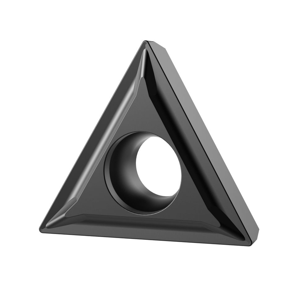

Plaquettes positives • TPGT-LF
Plaquettes vissées
Numéro de matériel1782831
Ref. ISO CatalogueTPGT090204LFRef. ANSI CatalogueTPGT18151LF
Screw-On TPGT ISO/ANSI Turning Insert 1782831 - Kennametal

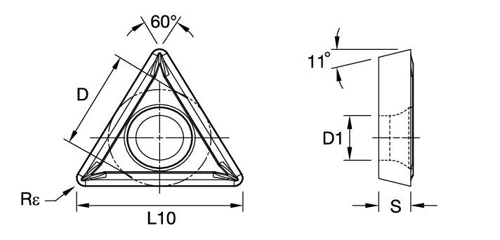

Drawings for 1782831
NuanceKC5410
[D] Taille de plaquette CI5.55 mm
[D] Taille de plaquette CI0.219 in
[L10] Longueur d’arête de coupe de la plaquette9.624 mm
[L10] Longueur d’arête de coupe de la plaquette0.3789 in
[S] Épaisseur de la plaquette2.381 mm
[S] Épaisseur de la plaquette0.0938 in
[Rε] Rayon de bec 0.4 mm
[Rε] Rayon de bec 0.016 in
[D1] Taille du trou de la plaquette 2.649 mm
[D1] Taille du trou de la plaquette 0.1043 in
Matériaux de pièce à usiner
  • Non ferreux
  • Matériaux CFRP
KC5410
KC5410
  • TiB2-PVD coating over a very deformation-resistant unalloyed substrate.
  • Designed for roughing, semifinishing, and finishing of free machining (hypoeutectic <12,2% Si) aluminium, aluminium alloys, and magnesium alloys.
  • High hardness and extremely smooth surface, resulting in reduced surface friction, speedy chip flow, and outstanding wear resistance.
  • Prevents built-up edge because of a very low affinity for aluminum.
  • Finishing geometry with light cutting action
  • Used in multiple material groups
