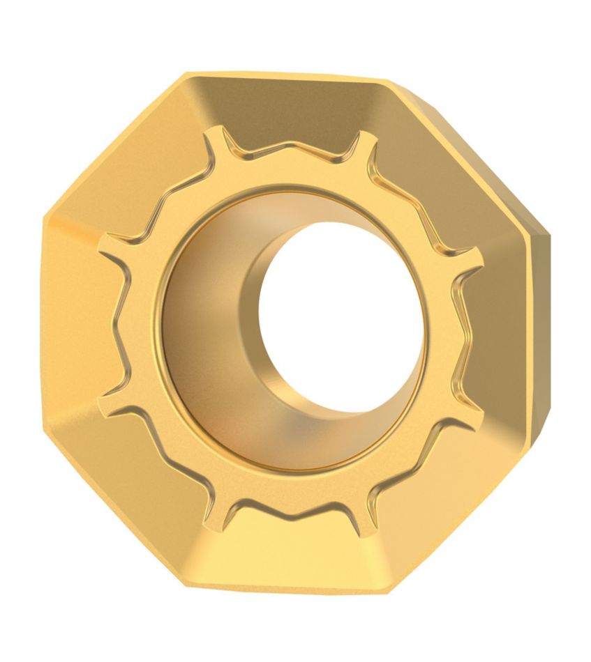

7745VOD04 Series • Carbide Insert • ODET-APEN44 • Light Machining of Steels and Stainless Steels
Face milling insert with eight cutting edges, precision ground.

GradeX500
[D] Insert IC Size12.8 mm
[D] Insert IC Size0.504 in
[S] Insert Thickness4.76 mm
[S] Insert Thickness0.187 in
[BS] Corner Facet Length 1.5 mm
[BS] Corner Facet Length 0.059 in
Average Chip Thickness [HM]0.04 mm
Average Chip Thickness [HM]0.002 in
X500
X500
CVD TiN/TiCN/TiN coated carbide on tough substrate (X-Grade™ technology). For difficult applications with heavy impacts, vibrations, or unstable conditions. High stability against thermal cracks. Excellent grade for high-temperature alloys, stainless steels, and titanium.
  • Precision ground insert for best run-out and tool life.
  • High positive rake for soft cutting action.
  • Embedded wiper facet for improved suface floor finish.
