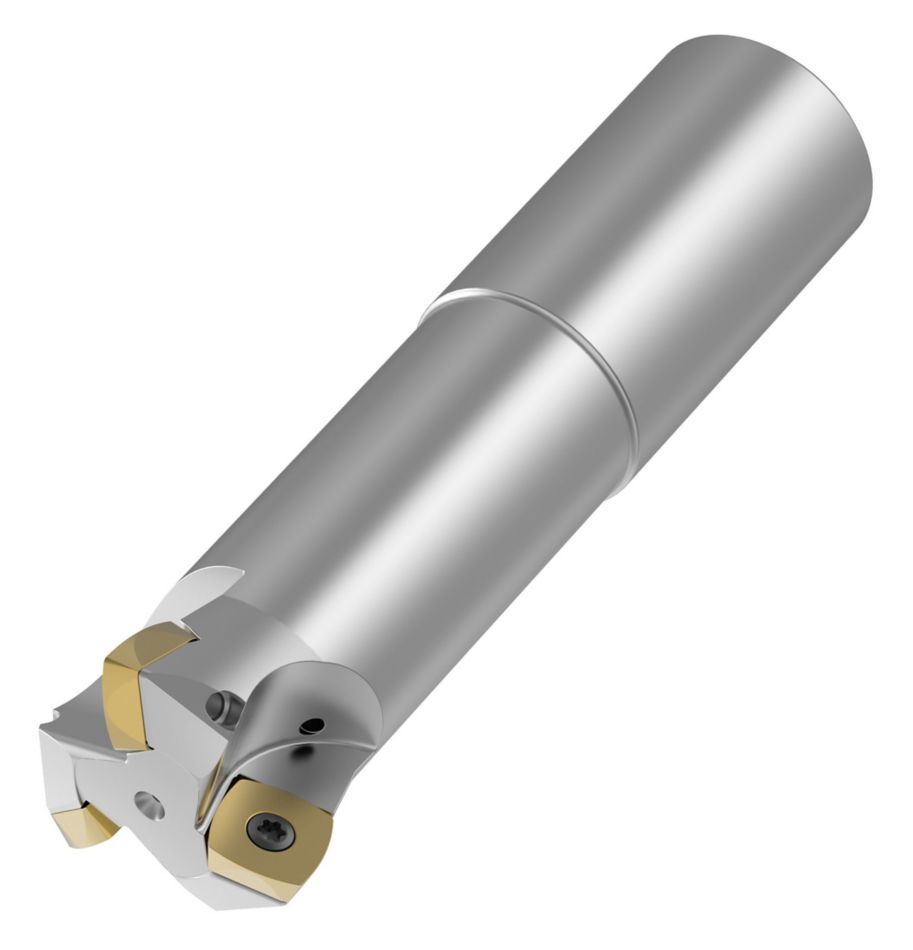

7792VXE16 Series • End Mill • Cylindrical Shank • Metric
High-Feed copy milling cutter for multiple materials.
Material Number5658651
ISO Catalog ID7792VXE16CA040Z2R102ANSI Catalog ID7792VXE16CA040Z2R102

Drawings for 5658651
[D1MAX] Maximum Cutting Diameter40 mm
[D1MAX] Maximum Cutting Diameter1.5748 in
[D] Adapter / Shank / Bore Diameter1.575 in
[D1] Effective Cutting Diameter16.239 mm
[D1] Effective Cutting Diameter0.6393 in
[L] Overall Length 172 mm
[L] Overall Length 6.7717 in
[L2] Head Length 102 mm
[L2] Head Length 4.0157 in
[AP1MAX] 1st Maximum Cutting Depth3.5 mm
[AP1MAX] 1st Maximum Cutting Depth0.1378 in
[Z] Number of Flutes2

  • Internal coolant supply.
  • Positive design to support low cutting forces and applications with long overhang.
